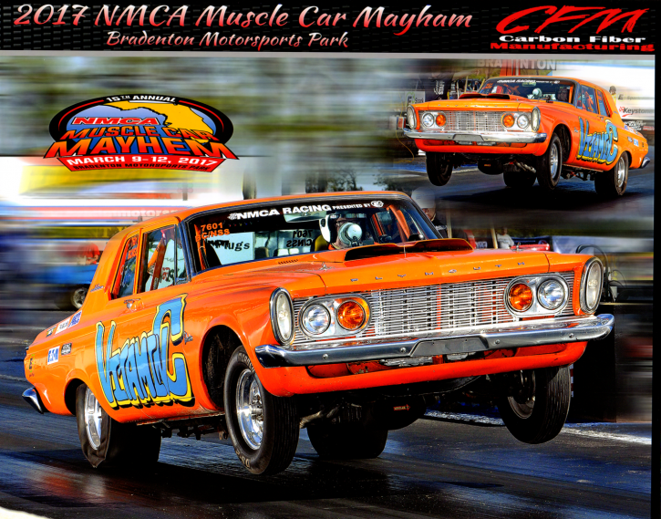

    What is the best Slick to run on a 63 Plymouth in Super Stock, and why?
    I hear some say 28x9 and others say 29.5x9

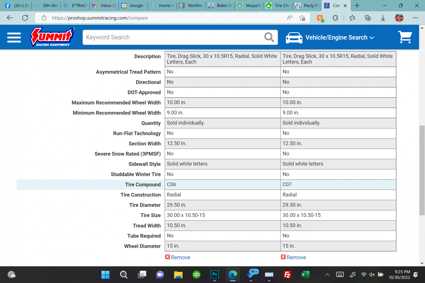

        Looking at the availability, there appears to be two different types of compounds. Which is better for my situation?
