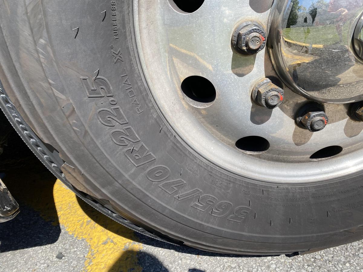

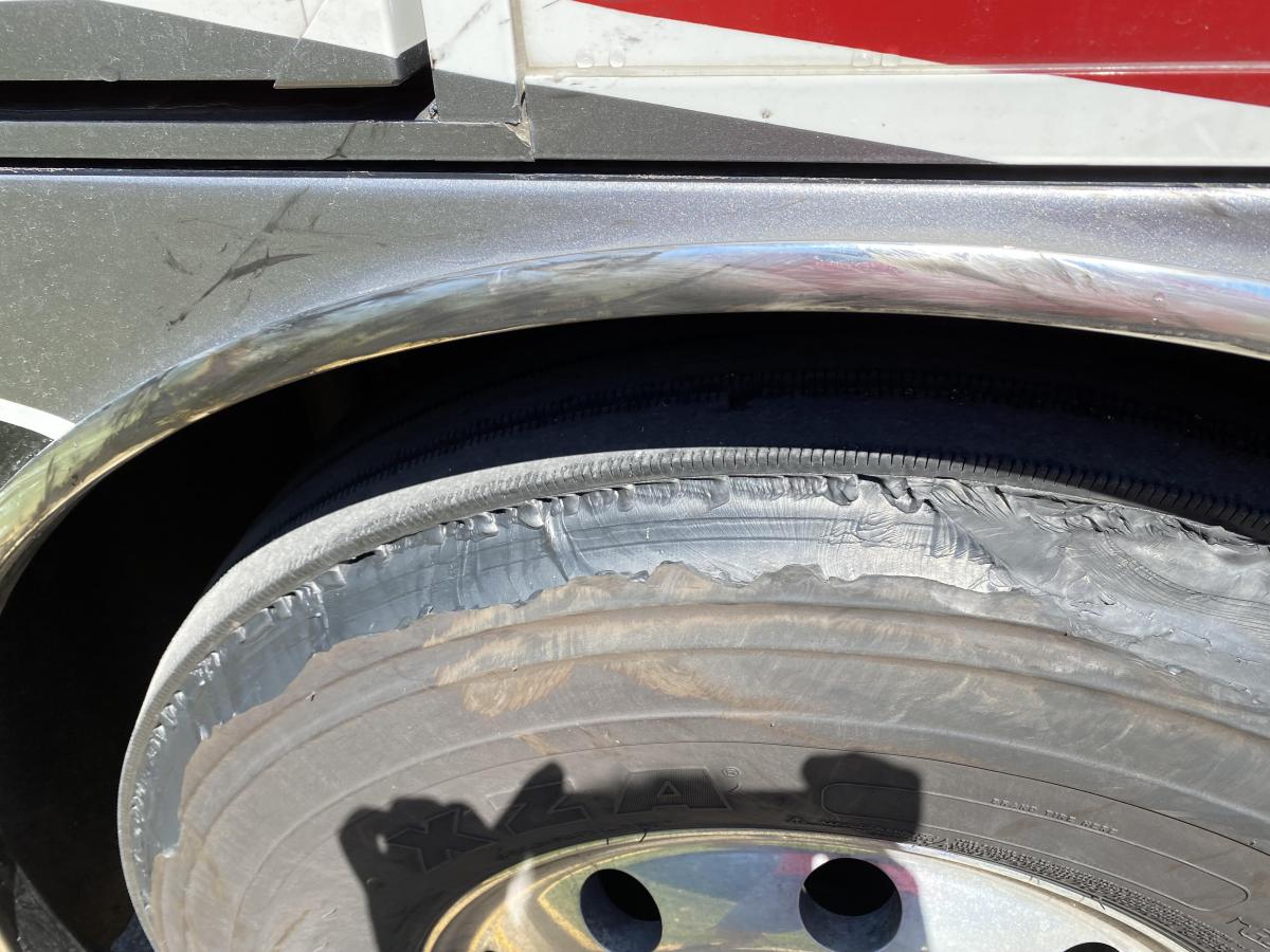

    While traveling to a race in Indy the curbside steering tire on my 2020 Cornerstone came apart and beat the Hell out of my coach. More specifically, the tire edge piece vulcanized between the sidewall and the tread broke off and then the sidewall became unglued.
    Coachnet spent 3 hours trying to locate something for me because the Michelin 365/70R-22.5 are on National back order with no date on when/if ever available again. They located me a nasty used tire in another state for $500 plus installation. They paid $545 to get it delivered to me.
    Once the roadside tire guy left, I saw a piece missing on the same edge piece of that tire. Then while filling up with diesel I noticed a piece missing out of the same edge of the steering tire on the street side of the coach. I'm not a big believer of a coincidence that three out of three tires are missing a chunk off the edge AND the tire is not only unavailable -- but there's no date projected on when they will be. Sounds to me like they know of a problem, but the Highway Safety Board doesn't yet.
ID:	93 Click image for larger version
      Getting the run around from Michelin and Spartan. The coach is at a Sparton Authorized Warranty facility - getting 8 new Tire Pressure/Temperature sensors, a new DEF head, the rear axles resealed, and my Cruise Control to stop shutting off when it rains - under warranty. Also two new Coach batteries for almost $600 on my dime. The repair guy says looks like tire defect and no evidence of rubbing - but they don't handle - call Michelin. Michelin says looks like a road hazard took chunk out of tires.

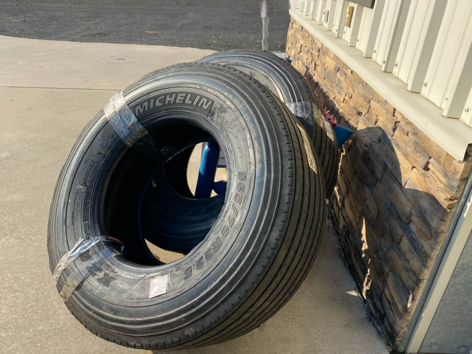

      I ordered a pair of new off eBay for $2590 with tax and delivery. I'll still need to pay to get installed.
ID:	565​New ones came in $2600 on ebay
